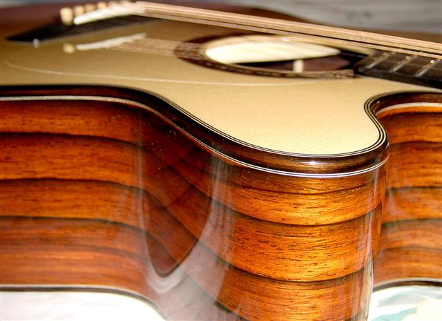

Although I have not figured out yet how to get a nice soft radius, I prefer the look and feel of something like this --
This by the way is a Mark Blanchard guitarLanceK38813.3319212963

What I think I would like most about using a round over bit would be the consistency of the cut. The fear would be destroying a guitar that is so close to being done.

1/8" radius sounds tempting.   Any idea what the radius on the Blanchard guitar's bindings is, Lance?

no idea what Mark uses? He probably uses his thumb and some mojo magic
His guitar oozzz class!

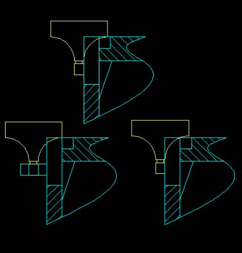

Be carful if your binding is .08 thick and you want to put an 1/8" radius on it with a roundover bit, you either need to inlarge the guide bearing dia. or set the depth of the bit higher than the router base or you will cut the radius past your binding and into your perfling or top/back.
Here is three profiles showing what I mean, The top one is a 1/8" roundover bit in normal position. It will cut into the purfling. The other 2 are the fixes
I think raising the bit is the best. By the way you would need to rase the bit .009" for a 1/8" roundover bit on .08 binding.MichaelP38814.4366435185

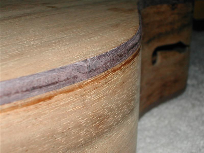

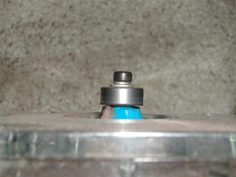

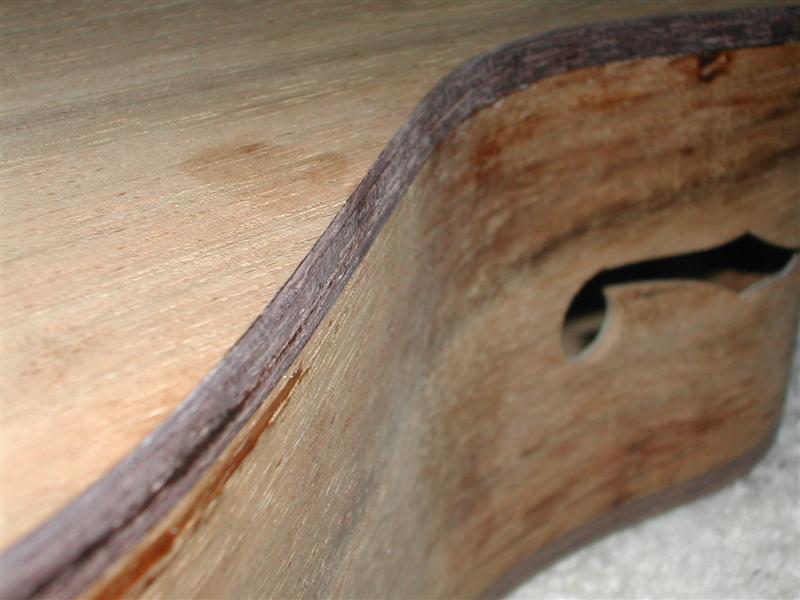

Hi all,
I just wanted to update on everyone regarding the 1/8" roundover bit.
I finally built up enough guts to put a laminate trimmer to the completed bouzouki body. Very scary thing to do, but it really worked out well. I first tested on scraps and measured how much the roundover would affect the purfling. I got mine set to not touch the purfling. Total setup time was about 10 minutes, and rounding over the binding edges for top and back were about 2 minutes. I stopped on the top where the fretboard meets the body so there will not be a gap under the fretboard.
Here are some shots. The first one shows half of the binding rounded over(the binding that is closest to the lower bout has been rounded over, and the binding towards the upper bout had not been done yet). The second shot is of the round-over bit setting in my laminate trimmer. The 3rd is the completed binding. I highly recommend this way of rounding over. It is no more scary than routing your binding channels! I'll probably offer these bits on my website some time soon. Thanks!
Tracytl50736238817.5021296296
